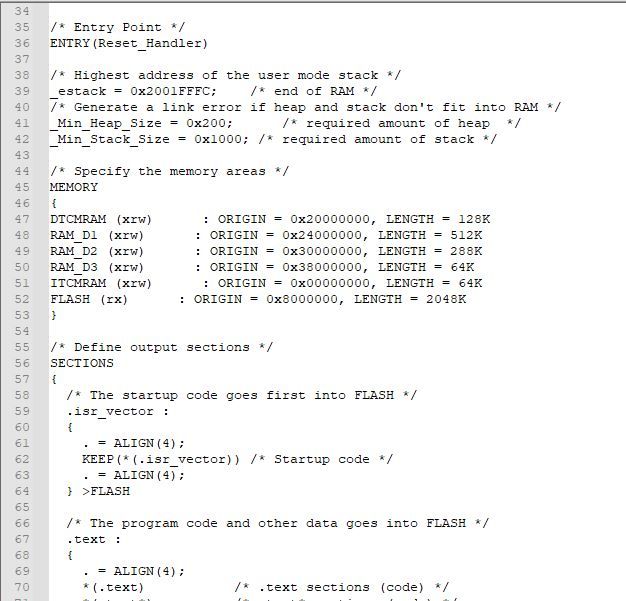

I am back and despite the change of linker script, there is no effect.
I dont understand why when i change end of RAM @0x2001FFFC, my APPLICATION_ADDRESS value is still stored @0x20020000 !
