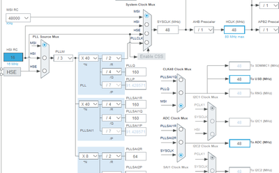

Hello, I am trying to send ADC data (12 bit) to pc with USB as fast as possible. Now I am using STM32F405 and configured ADC like picture below. Those data of ADC is transfered to the pc by interrupt of DMA which is cirucular mode. And the data transfer rate is around 10k bps. Is this reasonable value? Is there better way to transfer faster than this ?

2023-07-10 5:24 AM
Can you please tell me how were you able to make USB and DMA working together? I am using the same clock configuration as you even the parameter setting for the DMA are same. When I disable the Continuous Conversion mode the USB port shows up but when I enable it; it doesn't show up.
PS: I am able to send a string when the ADC and DMA were disabled.
