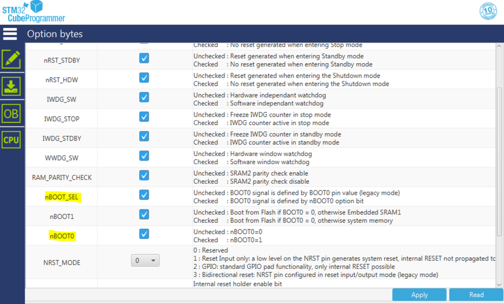

For better explanation I did attach an screenshot of the CubeProgrammer software showing the option bytes you need to modify.
All you need is to uncheck the needed option and press "Apply"
The connection of the board via the CubeProgrammer software is through ST-Link probe.
