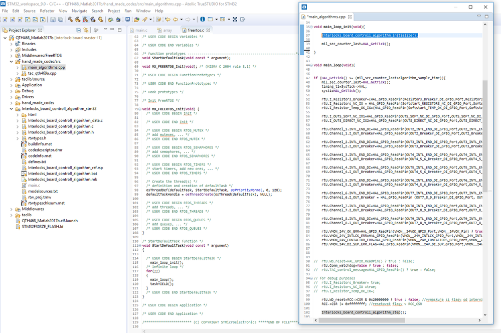

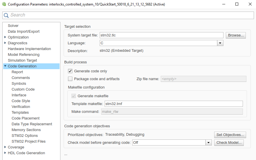

My company uses FreeRTOS also. For testing and developing algorithm I uses possibilities of the STM32/MATTARGET without the FreeRTOS (PIL.., algorithm is runninig in bareboard, just generated from STM32 target in simulink). For the final implementaion (or well running algorithms) only generated source files are added to manualy created project (in Atollic TrueSTUDIO in my case). It is the most easier way without possibility online connecting with simulink, so debuging is complicate. Short description bellow.
I use generated code from simulink with FreeRTOS in that way:
1) In simulink, for code generation I have set Generate code only. Folder with source and header files is created (in my case folder interlocks_boad_controll_algorithm_stm32).
2) in Atollic TrueSTUDIO the link to the folder is added to the project (simulink model modification and regeneration of source files are provide automatically to the development tool, in this way)
3) FreeRTOS Task which uses generated step and initialization functions from simulink is created manualy. Some code to satisfy sample time is added line47.
In this application the generated codes running together with proprietal communication stack (legacy C++ codes). In simulink I have created interface from and to the communication stact throught data structures. The communication stack is running in the same main_loop function without the sample time (to eliminate multiprocess communication issues). It was very easy controll board. I used it for testing codegeneration and stateflow (8 state machine is running paralel).
