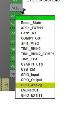

I'm using "STM32L452CC".
PA11 pin in connected to battery level checking part.
But I can check only ADC1_EXTI11,
and I'm using ADC1_IN5,6,7,8,9(PA0,1,2,3,4 pins) DMA_cirgular.
So, for battery level checking, I wanna use "GPIO_Analog".
But i cannot search any example or any function in stm32l4xx_hal_gpio.c, stm32l4xx_hal_adc.c or in hal library.
How can I get the value of gpio_analog pin?

Please check in the L4 repository, you can find some examples:
C:\Users\$USER\STM32Cube\Repository\STM32Cube_FW_L4_V1.14.0\Projects\NUCLEO-L452RE\Examples\ADC\ADC_RegularConversion_Polling
