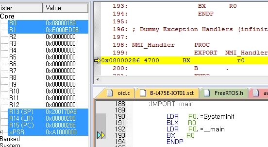

but when i created uVision project by myself. it didn't work.
it stopped at hardfault like below.
if possible, I want to convert .ld file into .sct file.

2019-08-13 6:20 PM
another comment :
First execution was run well after building and loading, there was no problem.
and then click "RST" button on uVision IDE.
when i run it second times, it goes into hardfault_handler..
2019-08-14 6:27 AM
I have solved this problem.
it's memory allocation error in scatter loader file.
I allocated UNINIT_FIXED_LOC section into external memory
I finally got to know the error debugging flash write execution.
