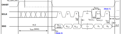

There are also ways to achieve this using DMA in the background that will not require CPU resources. Consider the following solution:
For reference, here is the waveform you need. TIM1_CH1 will be CONVST. SPI1_SCK is SCLK, SPI1_MISO is SDO.
I would recommend working with registers directly for this instead of using HAL. The reference manual will be your friend here.

How much is N?
Besides of the timer method - which is the most flexible - some of these ADCs could be pulled out by I2S; others by SPI in Rx-Only (thus constantly running) in TI mode.

@ Jan: I guess your question about N concerned the #bytes to transfer for one cycle (?) A: 4000 uint16_t or 8000bytes.
