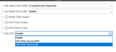

first, the only option available is USB_OTG_HS,
second, the CRS SYNC Source USB does not show up and if don't use an external oscillator the USB is not available at all.

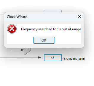

and last but not the least, if I try to setup the clock with values different from 16,20,24,26 and 32 Mhz I get this error (why this happens is documented in RM0456 but I don't know what should I do)
