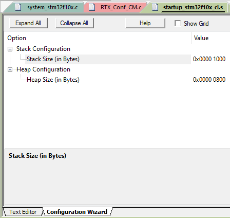

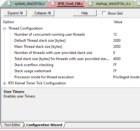

In a Ethernet communication, my MCU stop working after some seconds which makes me crazy. I will be thankful if you could help me to set the stack/heap and other parameters of RTX and my MCU startup file in order to find my problem better.
I need to have a Network connection (UDP)/USART3/Timer. Based on my requirement and
https://www.keil.com/pack/doc/mw/Network/html/nw_resource_requirements.html
how do you suggest to set these value for my application. Please provide me some numbers to get a good sense of setting of these variables.

Are you sure those are the problem? 0x1000 is quite a lot of stack space.
I would suggest using the debugger to figure out why the program "stops working" and debug that. If you have a memory leak, no amount of heap space is going to save you.
