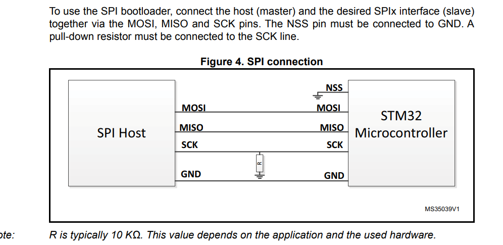

You are referring to AN2606, section 4.3, Hardware connection requirements, right?
In order not to interpret interspersed interference pulses as an apparent clock pulse to SCK during periods where SCK is floating, the connection line should be pulled low.
Does it answer your question?

Yes i reffered the AN2606. Thanks for your answer. You explained well.
