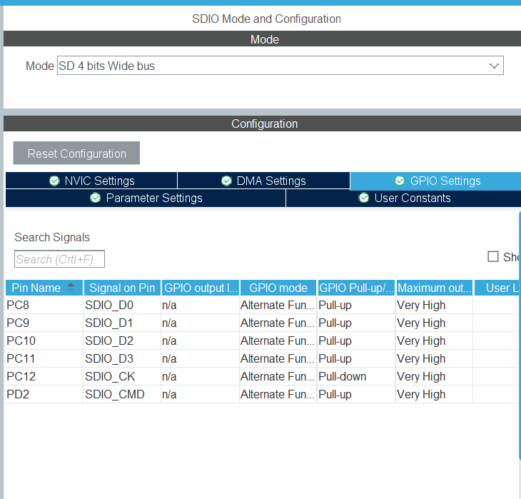

did you placed all the pullups?https://community.st.com/s/question/0D50X00009XkfrVSAR/using-internal-pullups-for-sdio-interface

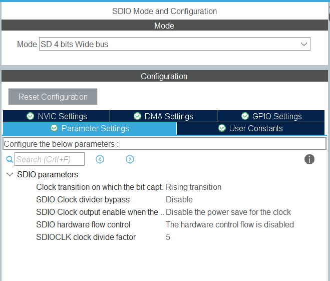

configuration in 4 bit mode:
0693W00000SuDWnQAN.pngMinimum heap size 0x200
minimum stack size 0x400
SDIO global interrupt-disable

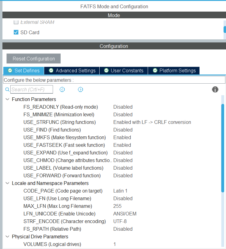

0693W00000SuDWdQAN.pngFatfs configuration:
the same code work if i generate sdio 1 bit mode with cubeMX .but in 4 bit mode it return FR_NOT_READY

4-BIT fussy to signal slewing, and correct mode selection at the card's command level.
Enable internally pull-ups on all lines except sdio _clk
