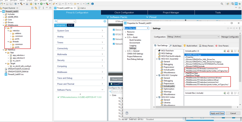

Then I selected my peripherals, timers, SPI, etc., in the .ioc, just as I did before on my F4 boards. However, this time I also selected software packs (Azure App, ThreadX, FileX, NeXtDuo, Network interface, BSP) similar to the STM32 video. So far so good, no problems, all green checks. When I then generate code it went a bit sideways. The file tree looks quite different form the examples, no \Application\User\ and also in the Middlewares, no \NX Core\, etc. and missing includes (nx_stm32_custom_driver.h).
I noticed a difference in capitalization, not sure where it matters and where it does not, "VOID" is certainly a mistake. I copied some of the errors below. When I open an example and clean and build it everything is fine, what do I have to do to make STM32CubeIDE do it in the same way?

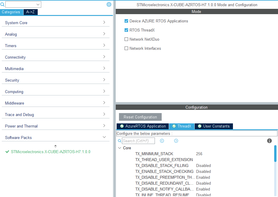

I think you didn't enable the Azure RTOS components in the Mode UI did you?
regards
haithem.
GRand.1
Associate II
Hello Haithem, no, I did enable all of them.
Greetings, Guenter
Haithem Rahmani
this is a bit strange as you can see below, my project is correctly configured.
are you using the STM32CubeIDE 1.6.0?

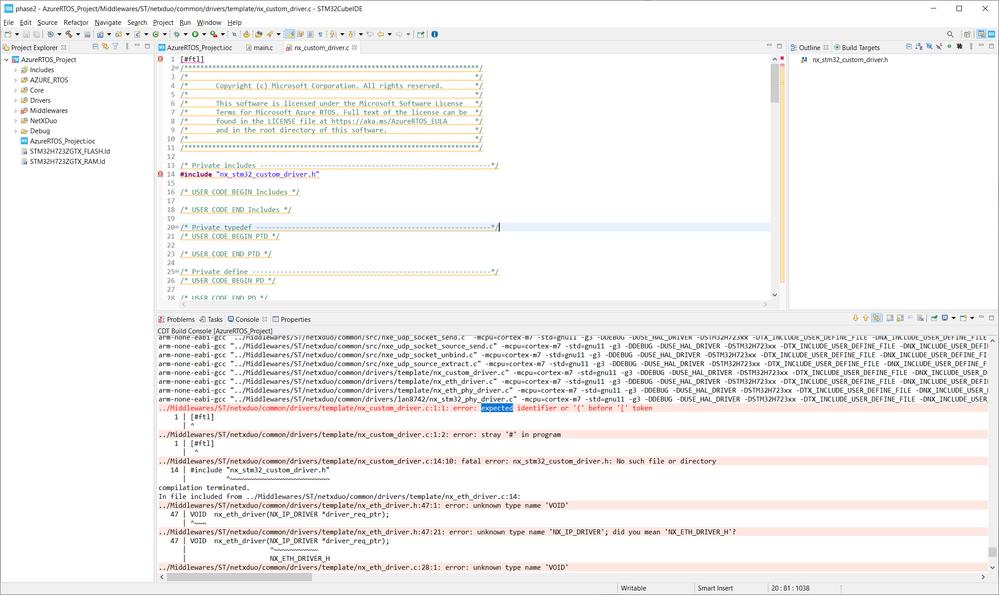

I followed the video and got the same results as I went though as you show. But at the end, when I clicked the "compile" button, the code would not compile.0693W000008zK2aQAE.pngIt appears there are syntax errors and numerous missing files?
arm-none-eabi-gcc "../Middlewares/ST/netxduo/common/drivers/lan8742/nx_stm32_phy_driver.c" -mcpu=cortex-m7 -std=gnu11 -g3 -DDEBUG -DUSE_HAL_DRIVER -DSTM32H723xx -DTX_INCLUDE_USER_DEFINE_FILE -DNX_INCLUDE_USER_DEFINE_FILE -c -I../Core/Inc -I../Drivers/STM32H7xx_HAL_Driver/Inc -I../Drivers/STM32H7xx_HAL_Driver/Inc/Legacy -I../Drivers/CMSIS/Device/ST/STM32H7xx/Include -I../Drivers/CMSIS/Include -I../AZURE_RTOS/App -I../NetXDuo/App -I../NetXDuo/Target -I../Drivers/BSP/Components/lan8742/ -I../Middlewares/ST/netxduo/common/drivers/ -I../Middlewares/ST/netxduo/addons/dhcp/ -I../Middlewares/ST/netxduo/common/inc/ -I../Middlewares/ST/netxduo/ports/cortex_m7/gnu/inc/ -I../Middlewares/ST/threadx/common/inc/ -I../Middlewares/ST/threadx/ports/cortex_m7/gnu/inc/ -O0 -ffunction-sections -fdata-sections -Wall -fstack-usage -MMD -MP -MF"Middlewares/ST/netxduo/common/drivers/lan8742/nx_stm32_phy_driver.d" -MT"Middlewares/ST/netxduo/common/drivers/lan8742/nx_stm32_phy_driver.o" --specs=nano.specs -mfpu=fpv5-d16 -mfloat-abi=hard -mthumb -o "Middlewares/ST/netxduo/common/drivers/lan8742/nx_stm32_phy_driver.o"
../Middlewares/ST/netxduo/common/drivers/template/nx_custom_driver.c:1:1: error: expected identifier or '(' before '[' token
    1 | [#ftl]
../Middlewares/ST/netxduo/common/drivers/template/nx_custom_driver.c:1:2: error: stray '#' in program
    1 | [#ftl]
../Middlewares/ST/netxduo/common/drivers/template/nx_custom_driver.c:14:10: fatal error: nx_stm32_custom_driver.h: No such file or directory
   14 | #include "nx_stm32_custom_driver.h"
compilation terminated.
In file included from ../Middlewares/ST/netxduo/common/drivers/template/nx_eth_driver.c:14:
../Middlewares/ST/netxduo/common/drivers/template/nx_eth_driver.h:47:1: error: unknown type name 'VOID'
   47 | VOID  nx_eth_driver(NX_IP_DRIVER *driver_req_ptr);
../Middlewares/ST/netxduo/common/drivers/template/nx_eth_driver.h:47:21: error: unknown type name 'NX_IP_DRIVER'; did you mean 'NX_ETH_DRIVER_H'?
      |                     NX_ETH_DRIVER_H
../Middlewares/ST/netxduo/common/drivers/template/nx_eth_driver.c:28:1: error: unknown type name 'VOID'
   28 | VOID  nx_eth_driver(NX_IP_DRIVER *driver_req_ptr)
../Middlewares/ST/netxduo/common/drivers/template/nx_eth_driver.c:28:21: error: unknown type name 'NX_IP_DRIVER'; did you mean 'NX_ETH_DRIVER_H'?
      |                     NX_ETH_DRIVER_H
make: *** [Middlewares/ST/netxduo/common/drivers/template/subdir.mk:25: Middlewares/ST/netxduo/common/drivers/template/nx_custom_driver.o] Error 1
make: *** Waiting for unfinished jobs....
make: *** [Middlewares/ST/netxduo/common/drivers/template/subdir.mk:27: Middlewares/ST/netxduo/common/drivers/template/nx_eth_driver.o] Error 1
In file included from ../Middlewares/ST/netxduo/common/drivers/template/nx_eth_phy_driver.c:14:
../Middlewares/ST/netxduo/common/drivers/template/nx_stm32_eth_config.h:22:10: fatal error: stm32NNxx_hal.h: No such file or directory
   22 | #include "stm32NNxx_hal.h"
make: *** [Middlewares/ST/netxduo/common/drivers/template/subdir.mk:29: Middlewares/ST/netxduo/common/drivers/template/nx_eth_phy_driver.o] Error 1
"make -j12 all" terminated with exit code 2. Build might be incomplete.
10:58:53 Build Failed. 12 errors, 0 warnings. (took 59s.354ms)
Any suggestions or things that might be worth trying?

I followed your screen cast (thank you for posting it) and run into the same problems as ADyke.1. The set-up was never an issue, although I started from a Nucleo template rather than from the uC like you, the problem started with the compiling.
  • the compiler does not know what "[#ftl]" is (and neither do I),
  • the include file "nx_stm32_custom_driver.h" does not exist in the ..\template\-path, only "nx_custom_driver.h"
  • the include file "stm32NNxx_hal.h" does not exist anywhere, should that be "stm32h7xx_hal.h" from ..\Drivers\STM32H7xx-HAL_DRIVER\..?
  • I guess once those issues are solved then so will be the others.
