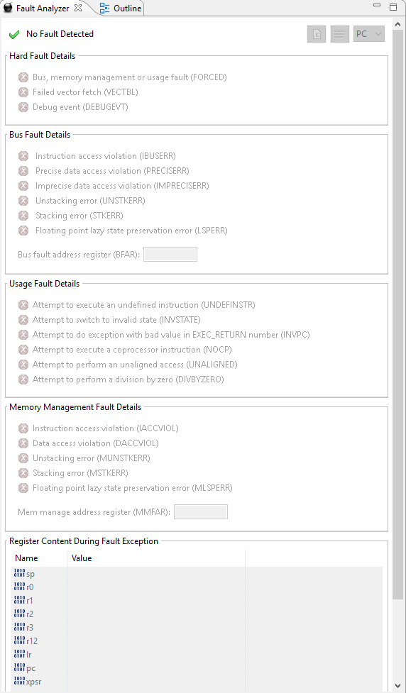

You can use the Atollic Truestudio Fault Analyzer available while debugging, it should give to you the information required.

2019-03-15 8:15 AM
