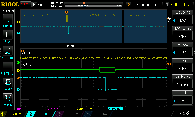

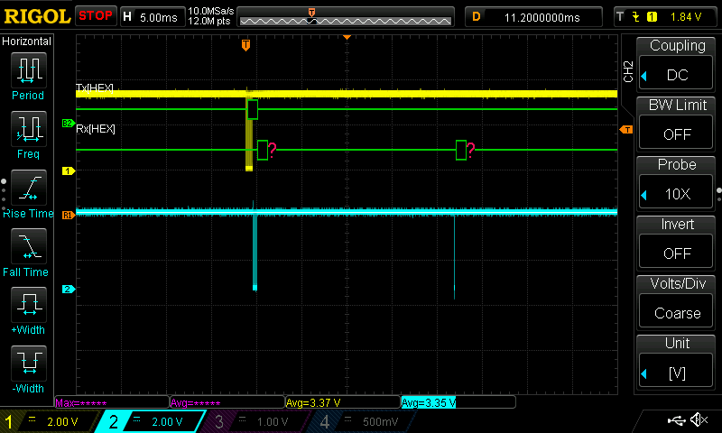

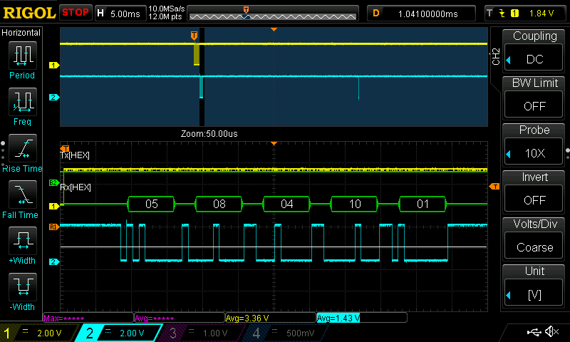

In my application, when the STM receives a packet, it sends out a packet with a confirmation. The content of the packets is not important. What matters is that sometimes the transmission of the packet, in this case, 6 bytes, is paused. As you can see in the images, it transmits 5 bytes, then pauses for about 22ms and then transmits the last byte.
This shouldn't happen as I called the function HAL_UART_Transmit_IT() passing the array with the 6 bytes to be written at once. They should be all transmitted together.
Does any one know what could cause this delay?
