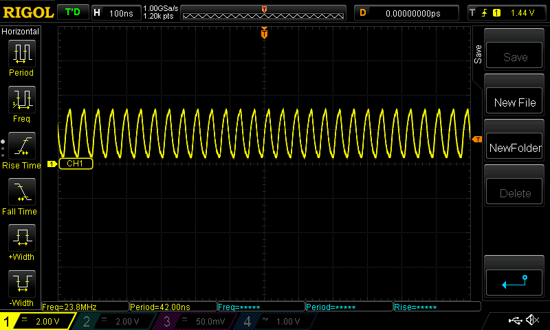

2021-04-04 2:10 AM
Hi to all,
After triple checked all (configuration and connection) I found the mistake.
The clock is too fast!
With oscilloscope on PC12 I see that the clock was not a square wave:

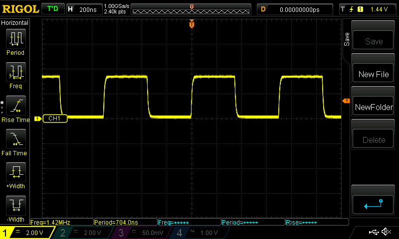

So I changed "SDIOCLK clock divide factor" in CubeMX from 0 to 32. Now the clock is ok:
and the file was successfully written into SD card.
