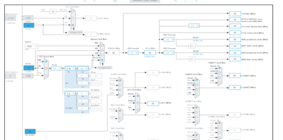

This is the screenshot of my clock configuration. In my understanding all timers should run at 80MHz. And guess what - I just did an additional test it magically works. So it seems that I did something wrong the other day.
thanks for all your support and suggestions
Markus

Hello @mkrug
Could please share with us your system clock config?
2025-02-05 7:26 AM
Sorry for being late in answering.
