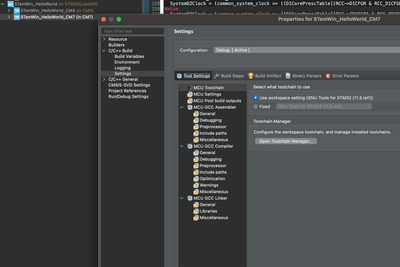

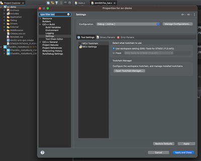

2023-11-23 12:18 PM - edited 2023-11-23 12:56 PM
IDE : STM32CubeIDE
Toolchain: GNU Tools for STM32(11.3.rel1)
Hello_World Project Tool Settings
My Project Tool Settings
As I mentioned earlier, the project is not created in a standard way as I wanted to make my project as cmake based. I had a feeling that because of that only Tool settings looks different. Is that creates this issue? Is there any way I can make a proper cmake project in STM32CubeIDE. I understood that if I enable Makefile generation as selected in STM32CubeIDE projects(make based), it enables additional options. I don't know whether that has something to do with my issue. Please take a look at my project structure and guide me to run some simple example in cmake way.
