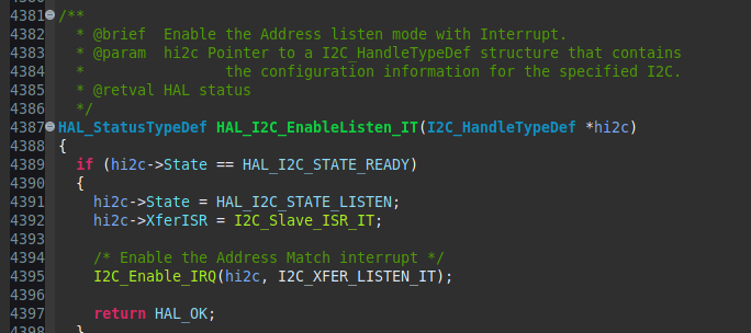

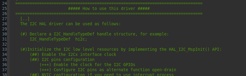

A basic description is in the HAL libs as comment , just see, whats in ../drivers/...HAL../src/..hal_i2c.c :
at first lines : general description
and in every function ..:
>and how to find the correct application for it?
Well, at first, you should know, what you want to do - the HAL is just a library, to get a certain function to work, not a teacher, to tell you, what to do now. :)

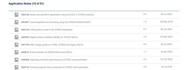

and see also the app notes etc. on STM , for a cpu you use ->
https://www.st.com/en/microcontrollers-microprocessors/stm32f407vg.html#documentation

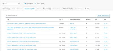

https://www.st.com/content/st_com/en/search.html#q=I2C%20HAL-t=resources-page=1
