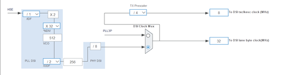

the application gets stuck on the Error_Handler() in the piece of code below in main.c
hdsi.Instance = DSI;
hdsi.Init.AutomaticClockLaneControl = DSI_AUTO_CLK_LANE_CTRL_DISABLE;
hdsi.Init.TXEscapeCkdiv = 4;
hdsi.Init.NumberOfLanes = DSI_TWO_DATA_LANES;
hdsi.Init.PHYFrequencyRange = DSI_DPHY_FRANGE_80MHZ_100MHZ;
hdsi.Init.PHYLowPowerOffset = PHY_LP_OFFSSET_0_CLKP;
PLLInit.PLLNDIV = 32;
PLLInit.PLLIDF = DSI_PLL_IN_DIV1;
PLLInit.PLLODF = DSI_PLL_OUT_DIV2;
PLLInit.PLLVCORange = DSI_DPHY_VCO_FRANGE_500MHZ_800MHZ;
PLLInit.PLLChargePump = DSI_PLL_CHARGE_PUMP_2000HZ_4400HZ;
PLLInit.PLLTuning = DSI_PLL_LOOP_FILTER_2000HZ_4400HZ;
if (HAL_DSI_Init(&hdsi, &PLLInit) != HAL_OK)
Error_Handler();
I just noticed that DSI lane clock is set to 32MHz - screenshot below - from the HSE (8MHz crystal) which seems too low. To what frequency (in the clock diagram page) do I set the two DSI clocks (DSI TXCLKESC and DSI lane byte clock)? How is that calculated?

Hello @Ricko;
The lane_byte_clk is calculated using the following formula:
FVCO=(HSE/IDF) X 2 XNDIV
Lane_Byte_CLK = FVCO / (2 x ODF x 8)
The Tx escape clock is calculated as follows: TX escape CLK = Lane_byte_CLK / TXECKDIV
Note: TXECKDIV must be programmed to ensure that the TX escape clock is less than 20 MHz.
The TX prescaler must be set to a value higher than 2. A prescaler value 0 or 1 disables the generation of the TX escape clock.

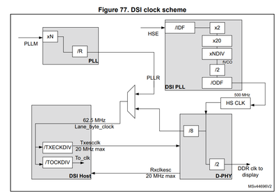

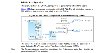

I recommend you to look at AN4860 and precisely 5.1.2 Clocks configuration section which mentioned a calculation example and DSI clock scheme.
