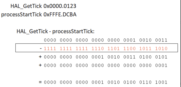

Why I think this is wrong: HAL_GetTick returns a uint32_t counter (at least in the ST libs I checked). This unsigned 32 bit value default increments 1000 times/s and overruns from 0xFFFFFFFF to 0x00000000 after ~49.71 days. Suppose the process started at Tick 0xFFFEDCBA. After adding the the wanted timeout (ex. ~74s), the timeout must trigger when Tick reaches 0x00000123. That value will be correctly calculated in the ST example. But 1 tick after the process started, Tick will be 0xFFFFEDCBB. Since that's bigger than the computed end value 0x123, the code incorrectly triggers a timeout after 1ms instead of 74s.
I believe it's better to do it this way:
uint32_t processStart = HAL_GetTick ();
if ((HAL_GetTick () - processStart) >= myAppTimeOut) { } //Timeout.
Here one can see this in the 2's complement result at the moment timeout triggers:
The relative timing code will generate at assembly level an overflow once Tick rolls over to 0x0, but in C that flag is discarded. As long as HAL_GetTick did not roll over to 0x0, the core reports no overflow. The relative timeout will be correctly handled in both cases (regardless if there's an overflow or not).
