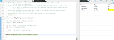

I am using a nucleo-f767zi to control a reverdi tft display.
The project in CUBEMX ide is using freertos and there for the time base is changed from systick to TIM6.
I am trying to task enable sequence for the screen but i see that i am stack in an infinite loop in HAL_delay() function.
I debbugged it and i see that when i stepped into the code program stops at :
__weak void HAL_Delay(uint32_t Delay)
uint32_t tickstart = HAL_GetTick();
uint32_t wait = Delay;
/* Add a freq to guarantee minimum wait */
if (wait < HAL_MAX_DELAY)
wait += (uint32_t)(uwTickFreq);
// it is blocked in side this loop. which means that HAL_GetTick() has issue.
while ((HAL_GetTick() - tickstart) < wait)
It seems that HAL_GetTick has issue so this means that i am missing some setup.

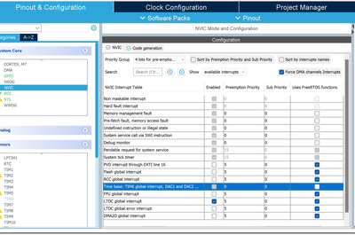

Project identifies TIM6 as base time and the interrupt is there in ioc

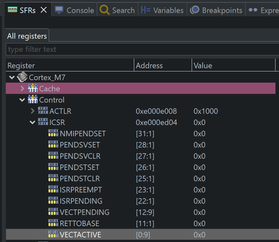

Okay so DIER=1 and the timer is running, which means the interrupt wants to fire. The NVIC bit also needs set but I bet it is. Now you need to determine why it's not firing. Probably interrupts are disabled, or you're running in a higher-priority interrupt.
Where are you calling HAL_Delay from?

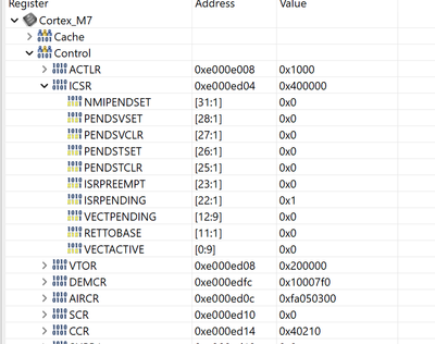

Show the contents of the SCB registers, in particular ICSR.

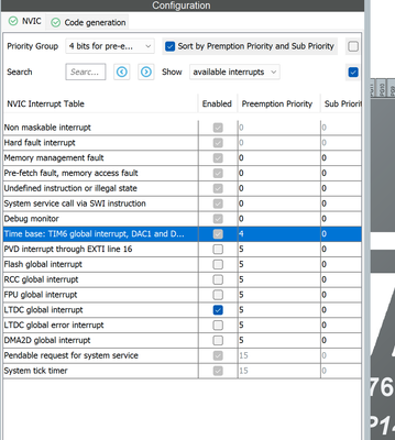

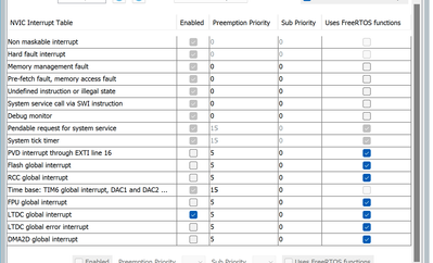

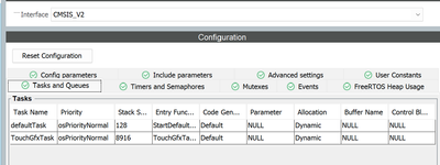

2023-08-18 1:42 PM - edited 2023-08-18 1:42 PM
For the interrupt and the priorities i have from ioc this:
This does not mean that it is ok? I also tried to make tim6 also priority = 0 from 15 but no change
And from the freertos i have two tasks with normal priority

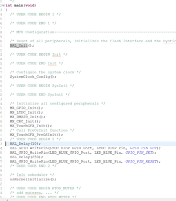

The Hal_delay i am calling it inside the main.c i am doing it after touchgfx init and before osKernel and freertos init.
As you see i am trying to make disp pin to go HIgh and to identify it without checking pin cause i do not now how to do it in debug from software side easily i use also one of the leds of the nukleo board.

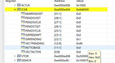

For the contents of the SCB registers, in particular ICSR what am i expecting to see as proper behaviour?

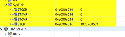

2023-08-18 2:45 PM - edited 2023-08-18 4:04 PM
Sorry for the delay. it seems that after Hal_Init function i have this stable
and after letting it too much time stuck in the while loop i see also
Tried also to enable interupts with __enable_irq() or should i try to enable interrupt only for tim6 like :
MX_GPIO_Init();
MX_LTDC_Init();
MX_DMA2D_Init();
MX_CRC_Init();
MX_TouchGFX_Init();
/* Call PreOsInit function */
MX_TouchGFX_PreOSInit();
/* USER CODE BEGIN 2 */
__enable_irq();
HAL_Delay(10);
HAL_GPIO_WritePin(LTDC_DISP_GPIO_Port, LTDC_DISP_Pin, GPIO_PIN_SET);
HAL_GPIO_WritePin(LED_BLUE_GPIO_Port, LED_BLUE_Pin, GPIO_PIN_SET);
HAL_Delay(250);
HAL_GPIO_WritePin(LED_BLUE_GPIO_Port, LED_BLUE_Pin, GPIO_PIN_RESET);
/* USER CODE END 2 */
And for the sysTick is see:

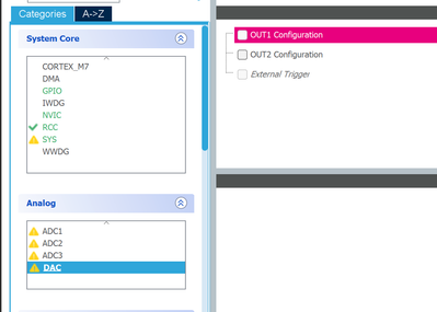

Trying to enable it with HAL_NVIC enable irw i found this strange thing that the TIM6 irq defined by the system it self includes DAC on the name :
HAL_NVIC_EnableIRQ(TIM6_DAC_IRQn);Also if you see previous posts for ioc and NVIC page it says "Time base: TIM6 global interrupt, DAC1 and DAC2 ...
but i have nothing set for DAC

2023-08-19 9:46 AM
I seems that when i set TIM6 priority at for which means more than LTDC it worked.
then i think i burned stlink but i opened another ticket for this. about the priorities is this the proper or the setup should be different in general
