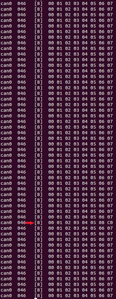

I'm using an STM32F103T8 who talks over CAN interface with a Raspberry Pi (MCP2515 Controller). The MC also uses USART1 for communication with a sensor module.
For testing purpose I've setup a simple program which sends continuously can frames of length 8 with a fixed payload [0,1,2,3,4,5,6,7]. Only the TxMailbox[0] is used.
The communication is working fine except randomly the last two bytes are not [0x06,0x07] but [0x08, 0xC0].

I've made a little test program to make it easier to analyzer the false can frame on the bus with a scope. The "false" can frame is actually correct on the bus. So all along it was not the MC's fault but the MCP2515 on the raspberry pi.
After more digging I've found out that the linux version used for the raspberry pi had a different spimaxfrequency default value in the device overlay for the MCP2515. After manually setting the spi max frequency to 10mhz the errors did not occure.
So I assume the spi interface for the MCP2515 was just a little bit too slow and didn't catch the complete buffer befor the next frame came into it?
