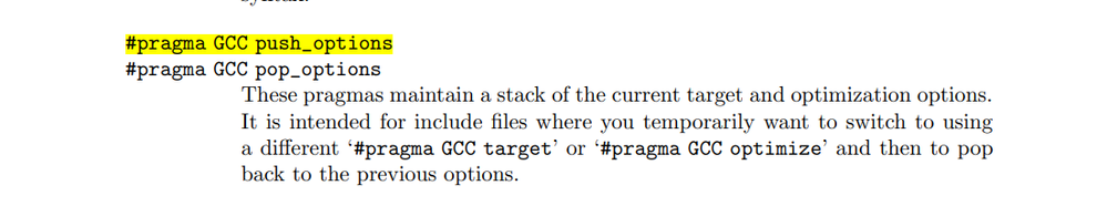

2025-06-16 2:09 AM
what is push_options and pop_options?
#pragma GCC push_options
#pragma GCC pop_options
Thank you.
2025-06-16 2:19 AM
Hello @carlesls2
Please check the GCC manual.

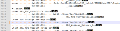

@carlesls2 wrote:the HAL_ADC_ConvCpltCallback has been optimized away.
How are you sure that the function has been optimised away?
As @Ozone suggests, if you haven't qualified things which get modified in the callback as volatile, then accesses to those variables may get optimised-out.
@carlesls2 wrote:I also check if the ADC_DMAConvCplt or HAL_ADC_IRQHandler or DMA1_Channel1_IRQHandler are being called, but they are not being called.
Sounds like the hardware interrupts are not happening...
2025-06-16 3:04 AM
I does not seem optimized away... it exists in the .map file. I guess this is not discarted... it seems not optimized away but it is never called. Yet this occurs when the optimization is applied.
