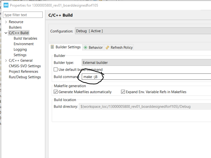

2021-02-18 12:05 AM
okay im giving this a try:
So first im looking where to add Pre-Build commands
project>properties>C/C++ buildShould i replace there the build command for:
version.h: git log -n 1 --format=format:"#define GIT_COMMIT \"%h\"%n" HEAD > $@; make -j8If i do i get some path errors, the ide is not finding version.h.
I tried adding the core/Inc folder to the path but no luck, i think my problem is somewhere else.
