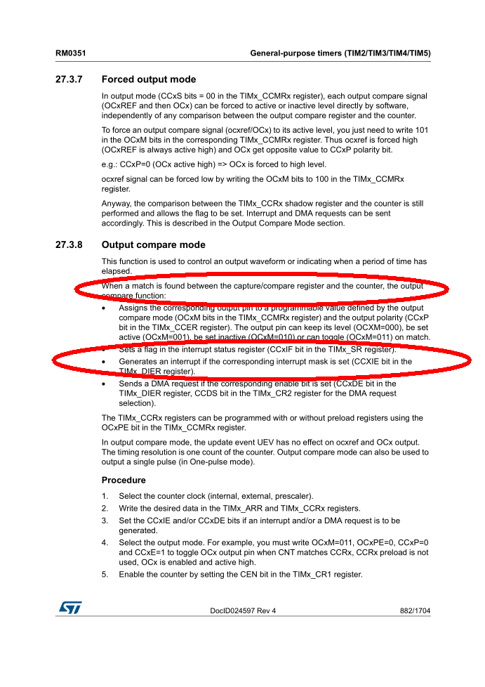

I want an interrupt whenever the TIM2 reaches a certain value (position).
That is, you want to use one of the capture-compare units in *compare* configuration, i.e. you want to throw an interrupt when timer's counter CNT matches the value set in CCRn.
The encoder mode uses CH1 and CH2 as input. While it won't necessarily propagate beyond the input filters, it precludes using those channels as *compare* which is an output rather than input feature.
Thus, set up CH3 or CH4 for the output compare (you don't need to actually enable it as output, nor set up a GPIO pin for it) and bind the interrupt to the chosen channel in DIER.
