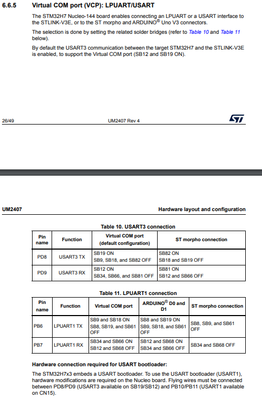

Hi HØdeg.1,
To write to serial port you can find the datasheet of your board. Lets say you have a STM32H7XX nucleo-144 board then USART3 is the port you want to configure to use the USB cable of your nucleo-144 board.
For Nucleo-144 H7 boards:
Then go to this chapter:
Then you will see this:
Here you can see that USART3 TX and RX configured to pins PD8 and PD9 will let you send data using the function HAL_Uart_transmit().
If you open something like PuTTy you can then read the data you send.
