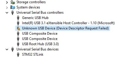

I just have tried to get a project running on a STM32F401RCT6 board that just should output the values of an uint16_t array by USB_OTG_FS , configured as VCP device. I started the built-in 'serial wire' debugger and stepped through all relevant statements of the main function 'MX_USB_DEVICE_Init()'. When I arrived inside the function 'USB_DevConnect(...)', the execution of the second statement (USBx_DEVICE->DCTL &= ~USB_OTG_DCTL_SDIS;) caused the windows popup "USB device not recognized".
In the Windows Device Manager I identified the related USB device, see:
As this project only contains the USB_OTG_FS and a small piece of code that produces the data-array to be exported I am stuck. The application seems to run in the main 'while(1)' as designed, except the fact the function 'CDC_Transmit_FS(....)' doesn't do anything because the OTG status is 'HAL_BUSY'.
