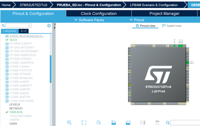

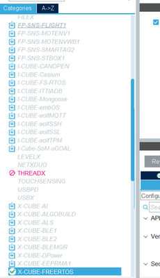

2025-06-04 2:58 AM
I say that because, when I try to configure my board on STM32Cube, FILEX(for using the SD) is avaiable if I choose ThreadX, but not with FreeRTOS.

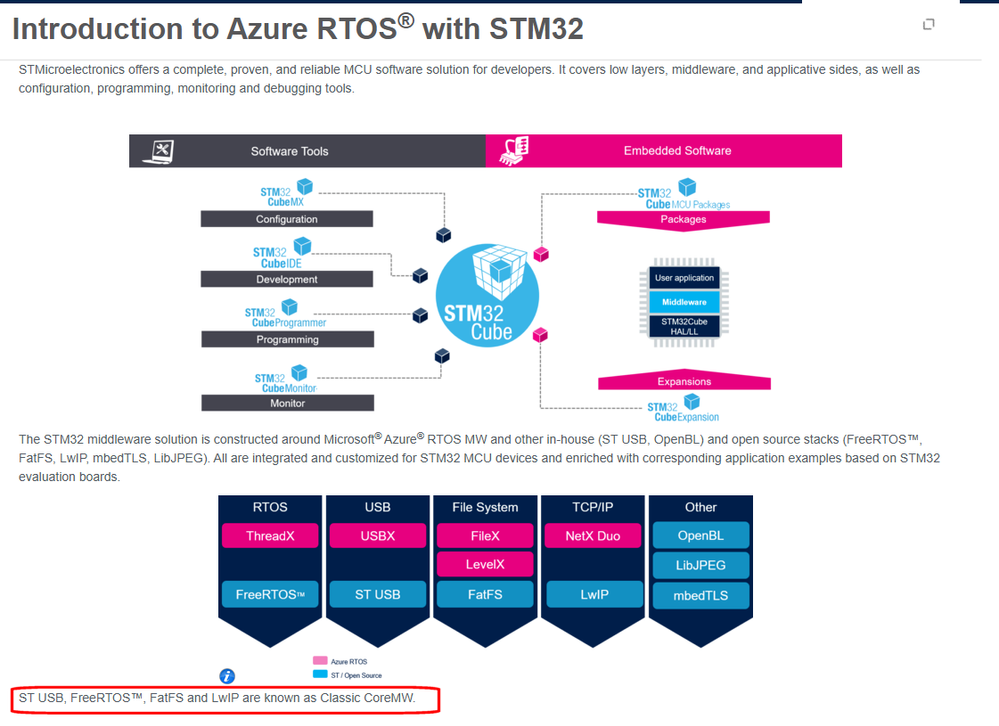

2025-06-04 3:10 AM
That's not a limitation of SD itself.
That's because FileX is part of the ThreadX (formerly "Azure RTOS") suite;
For FreeRTOS, FatFS was used as the filesystem component:
https://wiki.st.com/stm32mcu/wiki/Introduction_to_Azure_RTOS_with_STM32
The New Direction is now to integrate FileX with FreeRTOS:
But they haven't done that yet.
