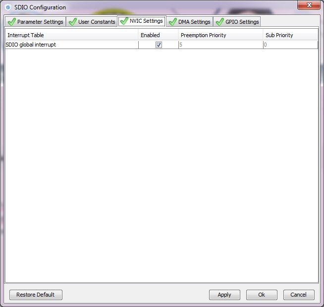

And what is the relation between SDIO preemption priority global interrupt with FreeRTOS ?
Thanks and have a good weekend

In answer to your second question - and the priority bits for an interrupt that uses the FreeRTOS interrupt safe API should be set to be pre-emption priority bits, not sub-priority bits. See the following link for more information:
