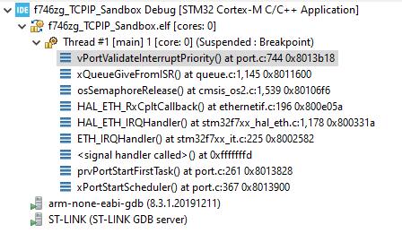

Only when the Nucleo is connected to the LAN, the debugger gets stuck at:
Line 744 of port.c (FreeRTOS source)
configASSERT( ucCurrentPriority >= ucMaxSysCallPriority );Trace (see image below):
The origin of the interrupt is the ETH_IRQHandler() respectively the HAL_ETH_RxCpltCallback()
I have been searching for this issue and understand that it has something to do with interrupt priorities. Why does this error occur? As I see it, the function call causing it is auto generated by HAL or implemented in the CMSIS source (osSemaphoreRelease).

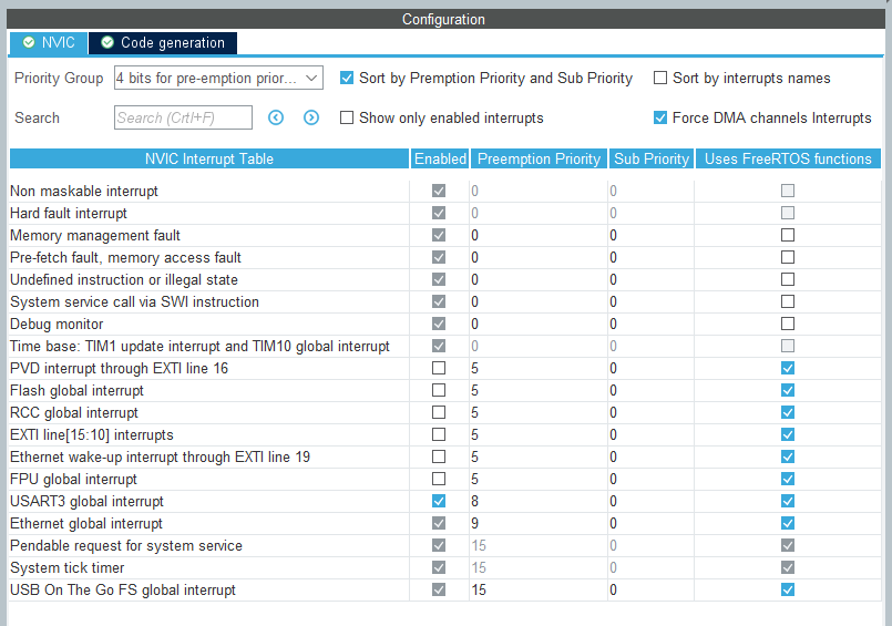

NVIC Interrupt Priorites are all below the RTOS max of 5 (see image below)
Changing then does not change the configASSERT error.
I am referencing this solution from 2018 which shows the exact same behaviour with the Ethernet connector. However, in my case the ETH Interrupt Priority is already at 9 (lower priority).
