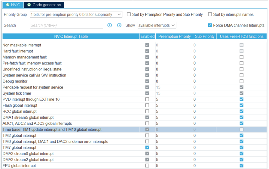

Someone posted a similar issue here: https://www.freertos.org/FreeRTOS_Support_Forum_Archive/August_2016/freertos_Usage_Fault_hard_fault_within_portYIELD_WITHIN_API_0efed9eej.html
and it seemed like the problem was interrupt configurations, but I checked FreeRTOSConfig.h and everything looks right to me. I also have a pic of my NVIC priorities in CubeMX:
#FreeRTOS #HardFault
