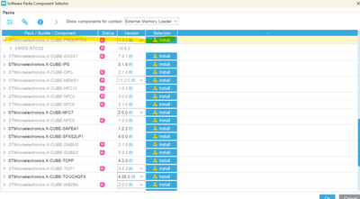

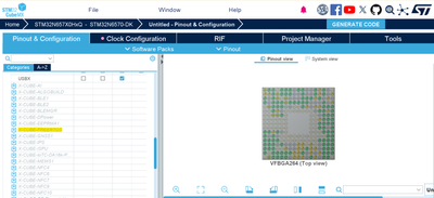

I’m currently working with the STM32N6570-DK board and would like to run a program using FreeRTOS. I’m having some trouble finding clear guidelines or examples specific to this board.

Hello @Konstantina
You can use X-Cube FreeRTOS in CubeMX.
Please refer to examples below to get started with X-cube FreeRTOS on N6 series:
