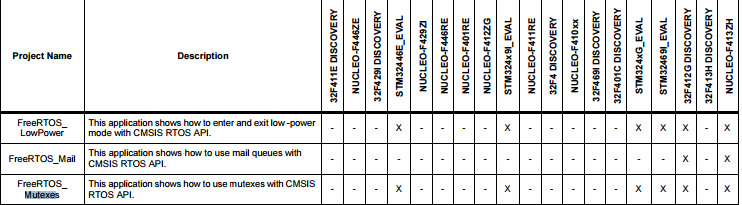

,In all STM32Cube packages, you will find an example called ''FreeRTOS_Mutexes''.
Just search it in the package you are using.
You can getmore details about mutexes in the
''Developing Applications on STM32Cube with RTOS'', sub-section ''Mutexes example''.If you are using an STM32F4, the example ''
FreeRTOS_Mutexes'' is available as application example for boards marked with ''x'' in this table (extracted from
:(-Amel
