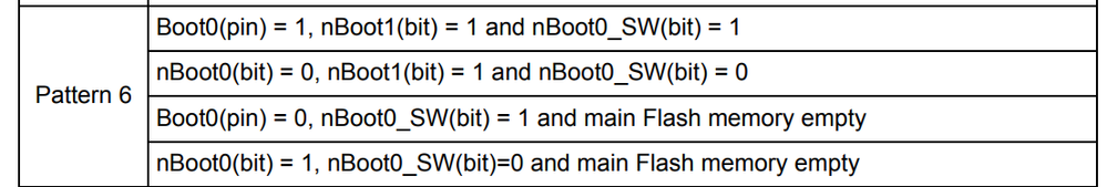

is any from this true? = Systembootloader start. Normal way i sprepare design for this.

I've seen this table, but nowhere else nboot is cited, so i have no idea if those are 1 or 0

Option bits is described on other places, but connect STLink and read it is first step.
Boot0(pin) describe external pin state. What isnt clean?
