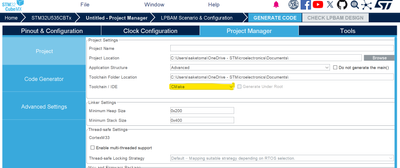

2025-06-16 1:33 AM - edited 2025-06-16 1:33 AM
Hello @nicolas
Please use the latest version of STM32CubeMX.
Got to the tab Project Manager and under the option Toolchain/ IDE choose Cmake.
2025-06-16 2:04 AM
Thanks for the answer. I wasn't able to convert the project because I was using STM32CubeIDE, now I can with STM32CubeMX.
But the generated CMake files are not using a hierarchical structure. So it doesn't help me for using CMake with the provided CMakeLists.txt found in stm32-mw-threadx and stm32-mw-filex.
