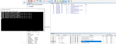

I am using STM32G491RE - NUCLEO. connected to the ADM3055e CAN Transceiver
Currently I am trying to send 12 Bytes of Data from IXXAT Terminal over to FDCAN1 which receives the message fine and then Output the Message on FDCAN2 though a buffer. So My logic is when a message pass the filter it gets called by the Fifo0Callback and push it to a buffer below. This works fine the buffer also get the full 12Bytes of data same FD format and everything checked out.
But when I try to add the message to HAL_FDCAN_AddMessageToTxFifoQ(&hfdcan2, &TxHeader2, TxData2). Where TxData is the dequeued message from the buffer and copys the 12Bytes. The message somehow gets truncated to 8Bytes on output.
Heck, when I add "if (HAL_FDCAN_GetTxFifoFreeLevel(&hfdcan2) > 0)", It somehow says it is full even when starting the code.
I have been suspecting because I cant set the HAL_FDCAN_ConfigTxBufferElementSize and HAL_FDCAN_ConfigRxBufferElementSize or even the messageRam offset like i could in the STM32H7 series. which may be causing the issue. Any Ideas on what I should do?

2026-02-06 4:29 AM - edited 2026-02-06 4:40 AM
Ok I found the issue....It's ridiculous simple mistake but it solved my issue.
I realised that when configuring TxHeader FDFormat my mistake was:
TxHeader1.FDFormat = FDCAN_FRAME_FD_BRS;
however it should be
TxHeader2.FDFormat = FDCAN_FD_CAN;
But anyways that solved my issue.
