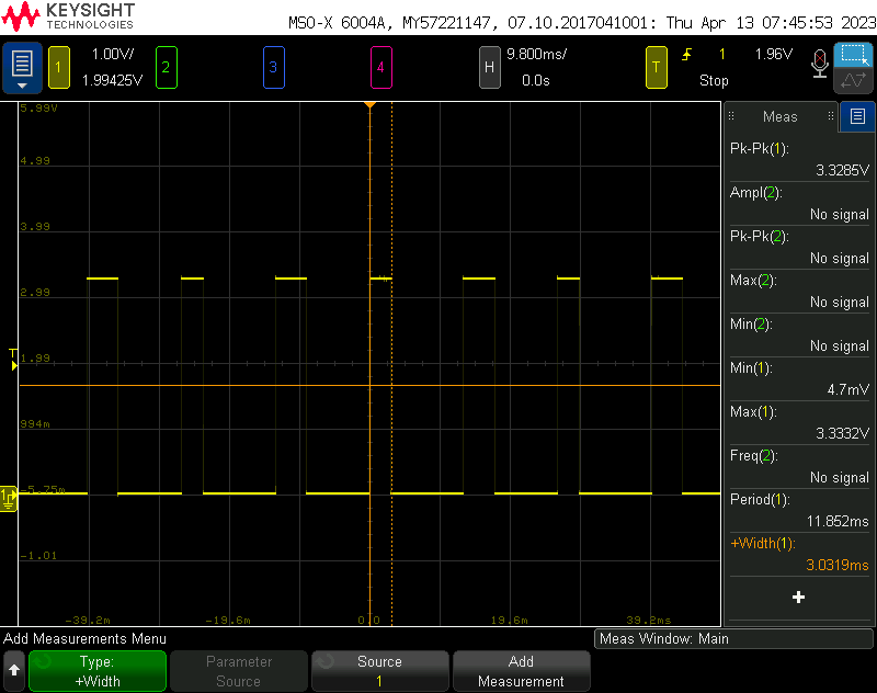

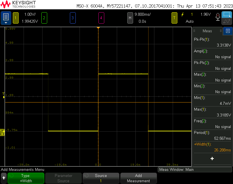

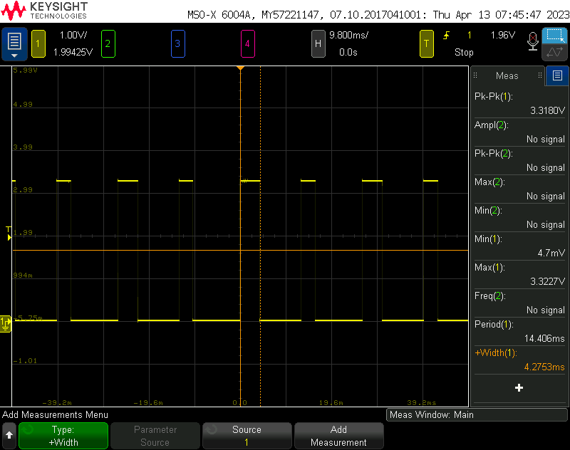

The pin is high while writing. In this picture. There are 2 different speeds, I don't know why. It saves a half faster.

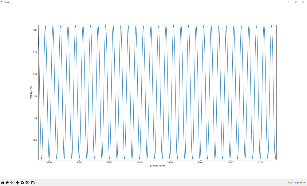

This is from the full callback pin toggle(14-bit ADC)
From 16-bit ADC
Seems like it is fast enough to save 14 bits and 16 bits. But plots look distorted from 16 bits ADC.
(These plots are from 32k buffer size, I couldn't get from 64k buffer because the board started to fail again)
14Bit

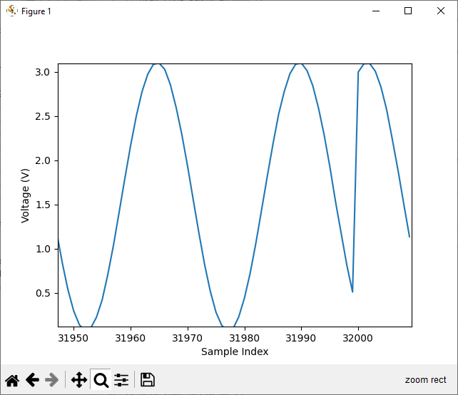

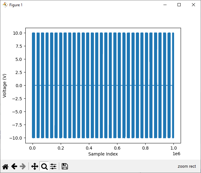

Also, I realized another problem. Some data gets lost between buffers(14 Bit)

dont know, i never tried. from dso-pics i see: in 5ms write 32KB , -> about 6MB/s ;
to do this with spi , 1 data line, need > 6x8 = 48Mbit .
try, if you get it working at 24...48 MHz clk, it could work.
try sd 1bit mode first.

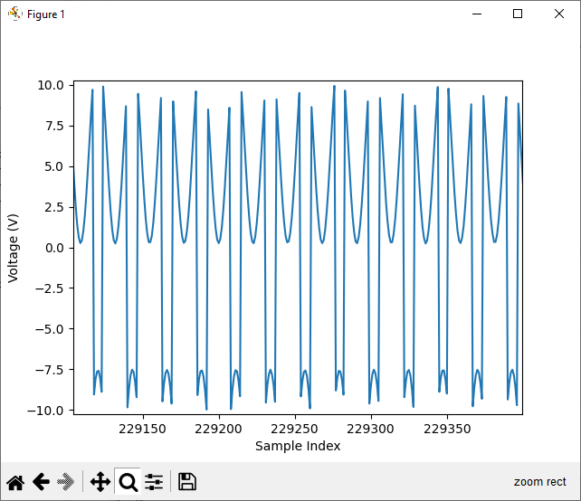

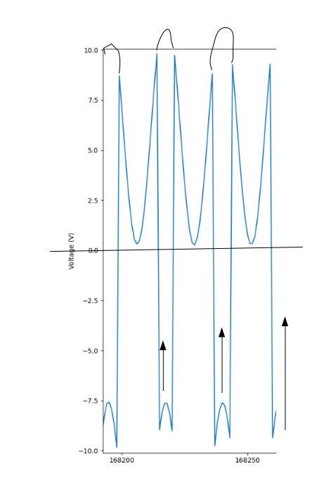

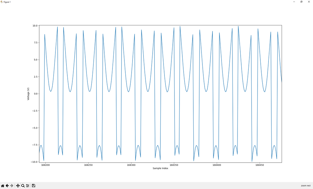

16 b "distortion" :
is wrap around , probably using a int16 for this uint16 data -> all >0x8000 getting negative by wrong variable use. or wrong bit shift, looks like this.
2023-04-14 2:20 PM - edited 2023-11-20 8:58 AM
Thanks again!
I changed all uint16t to uint32t, but 16bit ADC plots still wrapped and uint32t brings back the zeros. Zeros still exist on 14 bit ADC with uint32t too(just changing adc_buf's uint16t to uint32t brings zeros)
Wrapped plots:
From zoomed out view(zeros again)

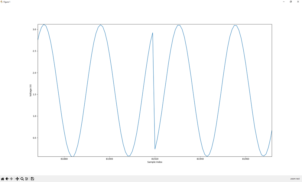

And I have data loses between half buffers.(14 bit adc, 64000 buffer) Writing speed is good, so it shouldn't be the problem. Also, I added an if code to get error message printer in case if it fills a half buffer before writing is done. So far no error. Is there anything to avoid this data loss?
Today, the board never gave any error about mounting. So, I didn't want to touch it and try SPI. But, if it does it again, I will change SDMMC pins to make soldered pins on sd card to sit directly on the board. Would it be problem if I use an I/O pin as a 3.3V power source?
just guessing: caches ON? set D-cache OFF , I-cache ON, optimizer -O2 .
>Wrapped plots:
first question: is data ok and just read/diagram is wrong or is data stored as "wrapped"? check stored data with hex editor, to see whats there on sd card.
and check adc setting in cube: 16bit, no oversampling, no bitshift left and no right shift.

>As for wrapped plots, the problem was my hex-to-plot phyton code. I totally forgot that, now it's okay.

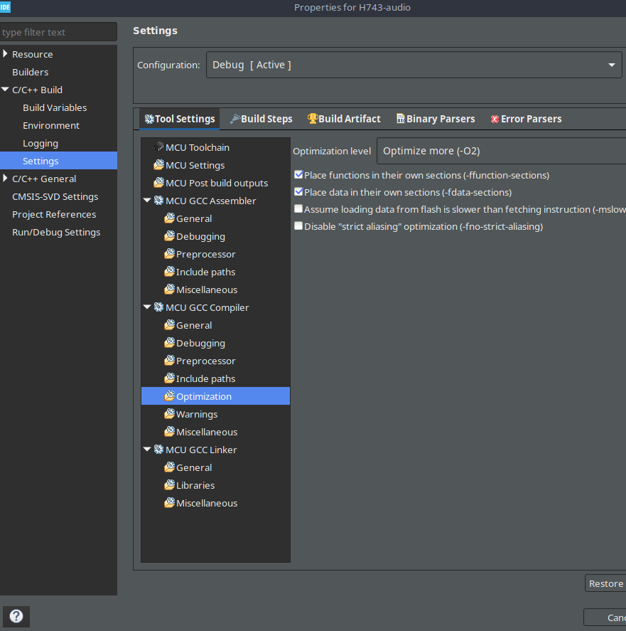

>set D-cache OFF , I-cache ON, optimizer -O2 ;
optimizer setting is in (while in your main file in editor) : project->properties->C..Build->settings ...
optimizer setting can change a lot , speed of cpu and code size, depends on setting.
ex.: i test on F303 , at 72MHz : pin set/reset in while-loop 65ns (but without Optimizer -O0. -> 260ns ).
data loss should not happen - try with optimizer on.

ok, so use : D-cache OFF, I-cache ON , opimizer -O2 .

to test with real timing, use 2 pins to check with DSO: pin1 set in 1/2-callback and reset in full-callback. pin2 set when processing of block begins, reset at end of write.
so can see , dual trace: when is data write start*end and is good "safety" time gap.
next test: give adc a (slow) triangle wave, to see, how big is the missing data time, because on slow rising/falling line we can "see" on DSO, about how much is missing.
(on fast sine we dont know: is part of one sine or 15.5 sine waves missing...)

I watched the writing process and half-full callbacks with an oscilloscope.
A half buffer gets ready in 28ms, writing process takes about 9ms. So speed is enough but writing speed fluctuates like 3ms-/+. Rarely it takes more than 30ms which is a problem. Then I prepared a PCB(cap added) to remove cables to make the sd card sit directly. It doesn't change anything in writing speeds and fluctuations, but I can use 100MHz now(It doesn't increase the writing speed as expected, it's like 7ms) and there are still +30ms writing rarely.
I made a mistake before, data loss happens in every quarter of a full buffer, not half. Do you have any idea about it?
