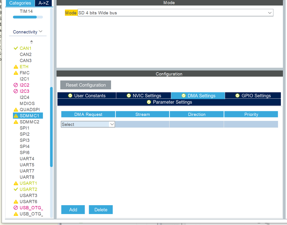

OK, DMA it is. CubeMX offers three DMA requests in the 'Select' drop down, so which do I want?
2020-10-21 7:00 AM
Not a CubeMX guy, the RM should provide details of the DMA plumbing options. The SDMMC/SDIO is half-duplex, so it is either reading or writing, it doesn't do both concurrently. Took ST a couple of part generations to determine this. Often 2x choices for RX/TX, choice usually depends on utilization by other peripheral sharing a stream/channel (limited mapping options). On the H7 DMA is done by the SDMMC1 peripheral itself.

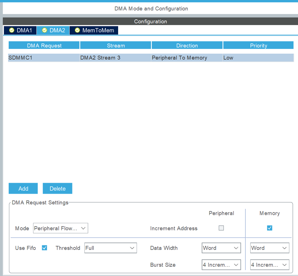

The STM32F7 reference manual is pretty helpful (section 39.3) but it's not completely clear how it relates to all the CubeMX settings. The good news is that the defaults for SDMMC DMA seem to work!
2020-10-29 4:54 AM
This is going backwards at a fair rate of knots! The settings I shared previously only worked for reads, not writes. I tried setting up two DMA streams, one for read and one for write, which seemed to help for a while. Now nothing works and I can't seem to get back to anything working.
