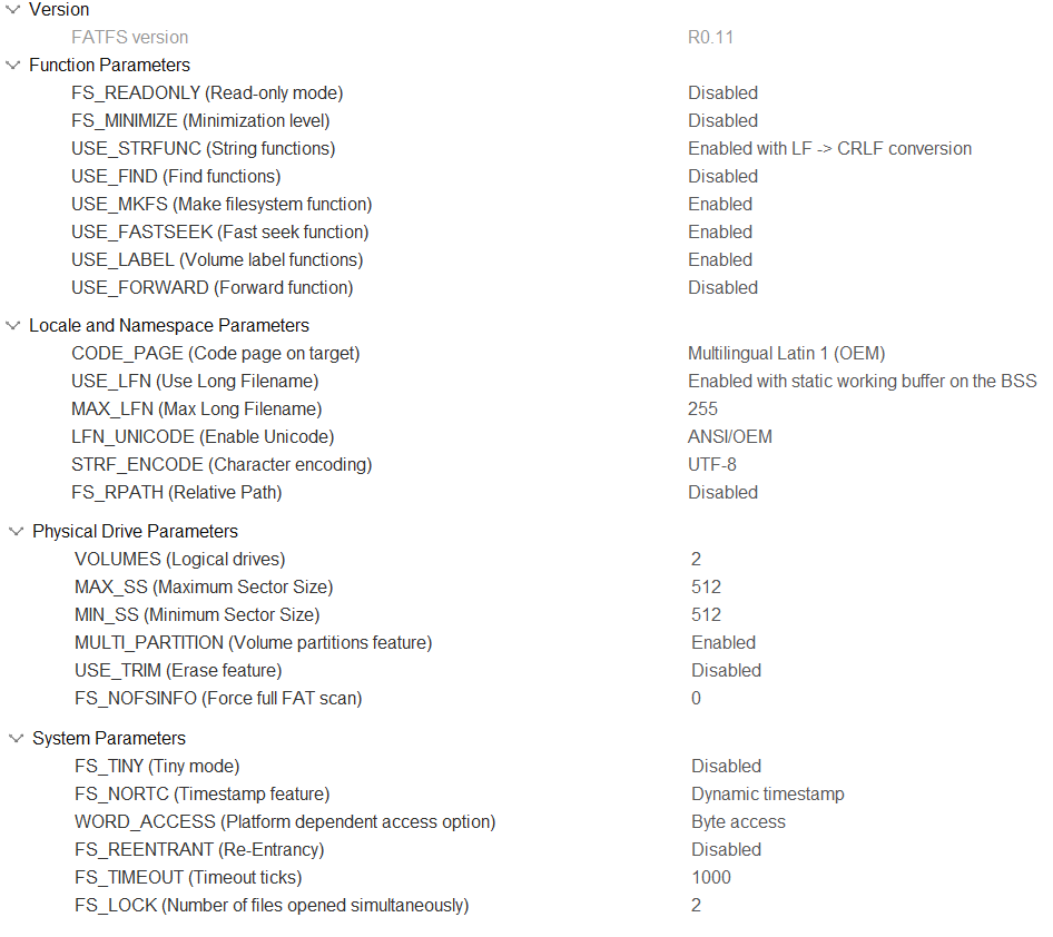

I am using FatFS on stm32f103RB MCU. I have a Single SPI bus and 2 CS pins for 2 SD Card.
used STM32CUBEIDE. No problem when I use 1 SD card and 1 CS pin. But Problem occurs when I use 2 SD Cards. Problem is SD Card 2 not mounting

fresult = f_close(&fil1);my FatFS library parameters :
I will be very happy if you can help :)
