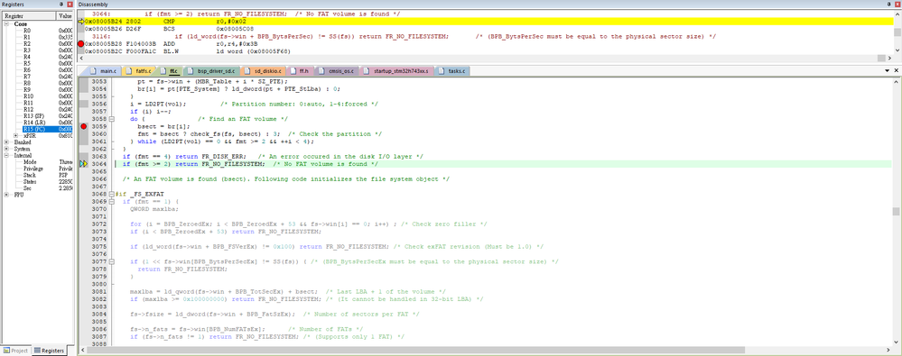

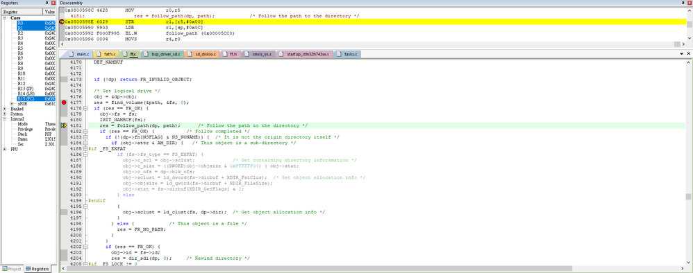

Debug Situation(In fmt ) -> it won`t get DISK ERR & NO_FILSYSTEM
Debug Situation(At follow_path) -> It returns Assertion failed
Please help!
