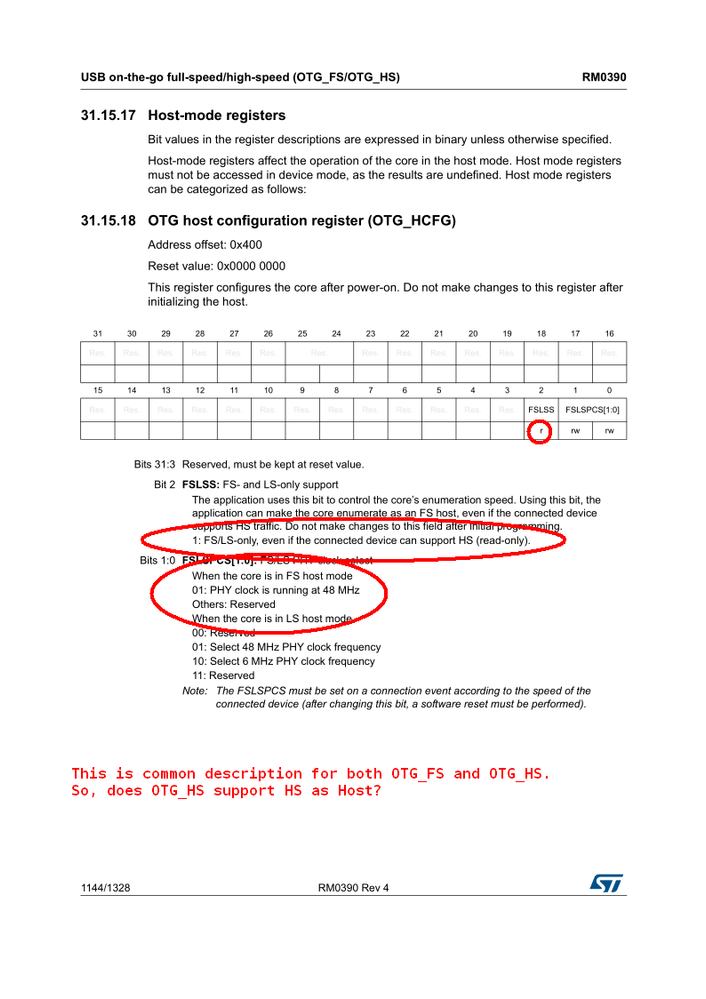

So, does OTG_HS support HS host mode?
Also, if FSLSS=1 and read only, shouldn't the reset value be 0x0004? In OTG_FS, it's 0x0200... (i.e. we again have here a bunch of undocumented bits). And FSLSS is *not* read only there, can be written to 0 or 1.
