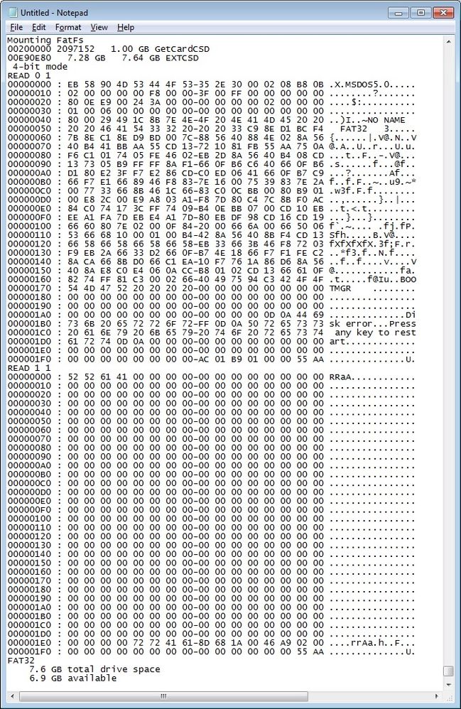

It is a file system on top of a block storage system. There are partition tables, boot sectors, directories, and block tables associated with writing your text to a file.
You should dump the 512 bytes in the block to better understand what is in this one. My guess would be your test string is in a preceding block that was written.
READ 0 1
00000000 : EB 58 90 4D 53 44 4F 53-35 2E 30 00 02 08 B8 0B .X.MSDOS5.0.....
00000010 : 02 00 00 00 00 F8 00 00-3F 00 FF 00 00 00 00 00 ........?.......
00000020 : 80 0E E9 00 24 3A 00 00-00 00 00 00 02 00 00 00 ....$:..........
00000030 : 01 00 06 00 00 00 00 00-00 00 00 00 00 00 00 00 ................
00000040 : 80 00 29 49 1C 8B 7E 4E-4F 20 4E 41 4D 45 20 20 ..)I..~NO NAME
00000050 : 20 20 46 41 54 33 32 20-20 20 33 C9 8E D1 BC F4 FAT32 3.....
00000060 : 7B 8E C1 8E D9 BD 00 7C-88 56 40 88 4E 02 8A 56 {......|.V@.N..V
00000070 : 40 B4 41 BB AA 55 CD 13-72 10 81 FB 55 AA 75 0A @.A..U..r...U.u.
00000080 : F6 C1 01 74 05 FE 46 02-EB 2D 8A 56 40 B4 08 CD ...t..F..-.V@...
00000090 : 13 73 05 B9 FF FF 8A F1-66 0F B6 C6 40 66 0F B6 .s......f...@f..
000000A0 : D1 80 E2 3F F7 E2 86 CD-C0 ED 06 41 66 0F B7 C9 ...?.......Af...
000000B0 : 66 F7 E1 66 89 46 F8 83-7E 16 00 75 39 83 7E 2A f..f.F..~..u9.~*
000000C0 : 00 77 33 66 8B 46 1C 66-83 C0 0C BB 00 80 B9 01 .w3f.F.f........
000000D0 : 00 E8 2C 00 E9 A8 03 A1-F8 7D 80 C4 7C 8B F0 AC ..,......}..|...
000000E0 : 84 C0 74 17 3C FF 74 09-B4 0E BB 07 00 CD 10 EB ..t.<.t.........
000000F0 : EE A1 FA 7D EB E4 A1 7D-80 EB DF 98 CD 16 CD 19 ...}...}........
00000100 : 66 60 80 7E 02 00 0F 84-20 00 66 6A 00 66 50 06 f`.~.... .fj.fP.
00000110 : 53 66 68 10 00 01 00 B4-42 8A 56 40 8B F4 CD 13 Sfh.....B.V@....
00000120 : 66 58 66 58 66 58 66 58-EB 33 66 3B 46 F8 72 03 fXfXfXfX.3f;F.r.
00000130 : F9 EB 2A 66 33 D2 66 0F-B7 4E 18 66 F7 F1 FE C2 ..*f3.f..N.f....
00000140 : 8A CA 66 8B D0 66 C1 EA-10 F7 76 1A 86 D6 8A 56 ..f..f....v....V
00000150 : 40 8A E8 C0 E4 06 0A CC-B8 01 02 CD 13 66 61 0F @............fa.
00000160 : 82 74 FF 81 C3 00 02 66-40 49 75 94 C3 42 4F 4F .t.....f@Iu..BOO
00000170 : 54 4D 47 52 20 20 20 20-00 00 00 00 00 00 00 00 TMGR ........
00000180 : 00 00 00 00 00 00 00 00-00 00 00 00 00 00 00 00 ................
00000190 : 00 00 00 00 00 00 00 00-00 00 00 00 00 00 00 00 ................
000001A0 : 00 00 00 00 00 00 00 00-00 00 00 00 0D 0A 44 69 ..............Di
000001B0 : 73 6B 20 65 72 72 6F 72-FF 0D 0A 50 72 65 73 73 sk error...Press
000001C0 : 20 61 6E 79 20 6B 65 79-20 74 6F 20 72 65 73 74 any key to rest
000001D0 : 61 72 74 0D 0A 00 00 00-00 00 00 00 00 00 00 00 art.............
000001E0 : 00 00 00 00 00 00 00 00-00 00 00 00 00 00 00 00 ................
000001F0 : 00 00 00 00 00 00 00 00-AC 01 B9 01 00 00 55 AA ..............U.
READ 1 1
00000000 : 52 52 61 41 00 00 00 00-00 00 00 00 00 00 00 00 RRaA............
00000010 : 00 00 00 00 00 00 00 00-00 00 00 00 00 00 00 00 ................
00000020 : 00 00 00 00 00 00 00 00-00 00 00 00 00 00 00 00 ................
00000030 : 00 00 00 00 00 00 00 00-00 00 00 00 00 00 00 00 ................
00000040 : 00 00 00 00 00 00 00 00-00 00 00 00 00 00 00 00 ................
00000050 : 00 00 00 00 00 00 00 00-00 00 00 00 00 00 00 00 ................
00000060 : 00 00 00 00 00 00 00 00-00 00 00 00 00 00 00 00 ................
00000070 : 00 00 00 00 00 00 00 00-00 00 00 00 00 00 00 00 ................
00000080 : 00 00 00 00 00 00 00 00-00 00 00 00 00 00 00 00 ................
00000090 : 00 00 00 00 00 00 00 00-00 00 00 00 00 00 00 00 ................
000000A0 : 00 00 00 00 00 00 00 00-00 00 00 00 00 00 00 00 ................
000000B0 : 00 00 00 00 00 00 00 00-00 00 00 00 00 00 00 00 ................
000000C0 : 00 00 00 00 00 00 00 00-00 00 00 00 00 00 00 00 ................
000000D0 : 00 00 00 00 00 00 00 00-00 00 00 00 00 00 00 00 ................
000000E0 : 00 00 00 00 00 00 00 00-00 00 00 00 00 00 00 00 ................
000000F0 : 00 00 00 00 00 00 00 00-00 00 00 00 00 00 00 00 ................
00000100 : 00 00 00 00 00 00 00 00-00 00 00 00 00 00 00 00 ................
00000110 : 00 00 00 00 00 00 00 00-00 00 00 00 00 00 00 00 ................
00000120 : 00 00 00 00 00 00 00 00-00 00 00 00 00 00 00 00 ................
00000130 : 00 00 00 00 00 00 00 00-00 00 00 00 00 00 00 00 ................
00000140 : 00 00 00 00 00 00 00 00-00 00 00 00 00 00 00 00 ................
00000150 : 00 00 00 00 00 00 00 00-00 00 00 00 00 00 00 00 ................
00000160 : 00 00 00 00 00 00 00 00-00 00 00 00 00 00 00 00 ................
00000170 : 00 00 00 00 00 00 00 00-00 00 00 00 00 00 00 00 ................
000001A0 : 00 00 00 00 00 00 00 00-00 00 00 00 00 00 00 00 ................
000001B0 : 00 00 00 00 00 00 00 00-00 00 00 00 00 00 00 00 ................
000001C0 : 00 00 00 00 00 00 00 00-00 00 00 00 00 00 00 00 ................
000001D0 : 00 00 00 00 00 00 00 00-00 00 00 00 00 00 00 00 ................
000001E0 : 00 00 00 00 72 72 41 61-8D 68 1A 00 46 A9 02 00 ....rrAa.h..F...
000001F0 : 00 00 00 00 00 00 00 00-00 00 00 00 00 00 55 AA ..............U.

Sorry, where/how would I 'dump' the block contents?

2018-08-02 11:34 AM
You'd instrument the disk_read and/or disk_write functions to call dumping routines that show you what's in the memory buffer.
