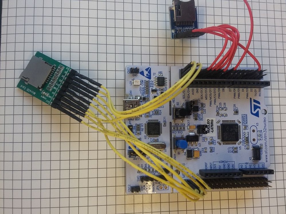

2018-07-13 1:27 PM
Thanks for the picture -- it seems our wiring is identical.
Sadly I have 4-5 other peripherals that need configuration for my project so Cube seems like the path of least resistance.
I've tried adapting ST's non-Cube HAL example (for L476G, which has an onboard SD slot), but maybe I ought to try harder. So far, however, it seems I just can't get it working even without Cube.
If it's of note, I believe the one 'good' flag above is FLAG_DBCKEND, meaning a data block was received and the corresponding CRC passed. It hangs here until the timeout is reached, returning HAL_SD_ERROR_TIMEOUT. It's not failing the CRC either, so the data just isn't being received.
