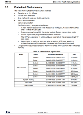

Sector 7 0x0806 0000 - 0x0807 FFFF 128 Kbytes .
In this 128Kb in would like use only the 2 last Kb . Can I erase only 2Kb on the sector 7 ?

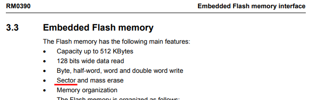

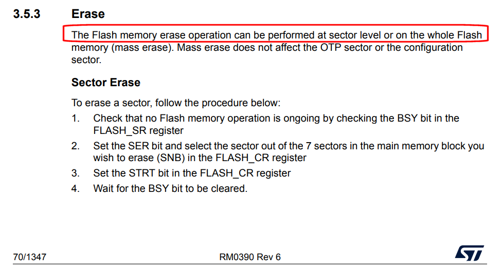

Surely the whole point of the "Sector" is that it defines the size which can be erased? You can only ever erase a whole sector - not a part thereof.
Surely, that's what the RM means by, "Sector erase":
And, explicitly:

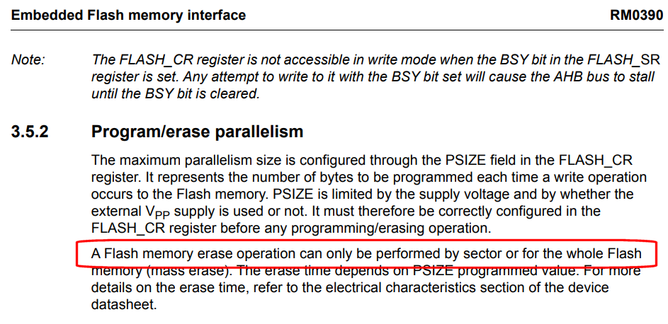

@JJoao.1 wrote:Can I erase only 2Kb on the sector 7 ?
No. The RM seems pretty clear to me - the Sector is the minimum unit of erasing.

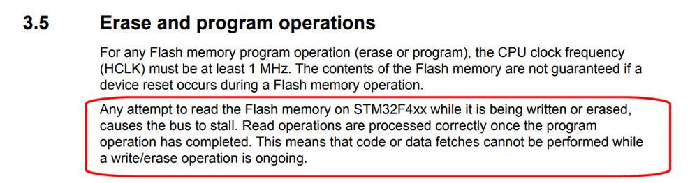

2025-04-23 6:02 AM
@Ozone wrote:And you cannot execute code from a Flash bank while under programming voltage.
@JJoao.1 see the RM:
