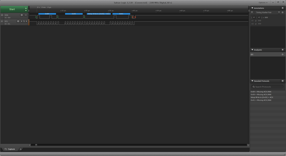

When I compile, and spy the communication port (I use a communication analyzer connected to the connector CN4 on pin 1 (SDA) and 3 (SCL)), I only see the address data sent from the MCU (STM32H743) to the slave (EEPROM), with no reply from the EEPROM (cf. screenshot below, 0x41 is the ASCII code of the first letter I try to send : 'A').
