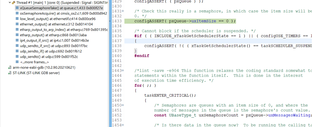

Further during communication testing we are observing tx semaphore value is going bad, pxQueue->uxItemSize is not zero, and communication stops, any idea on this,

Very often this kind of (internal) data corruption is caused by stack overflows. Did you enable stack checking or verified that you provide sufficient stack to.your tasks ?
2nd cause are incorrect NVIC interrupt priorities not matching FreeRTOS configuration.
Did you also define configASSERT for development ?

Recently another bug was reported:
https://community.st.com/s/question/0D53W00001oImr4SAC/bug-stm32-lwip-ethernet-driver-tx-deadlock
And have you fixed all multi-threading related flaws?
