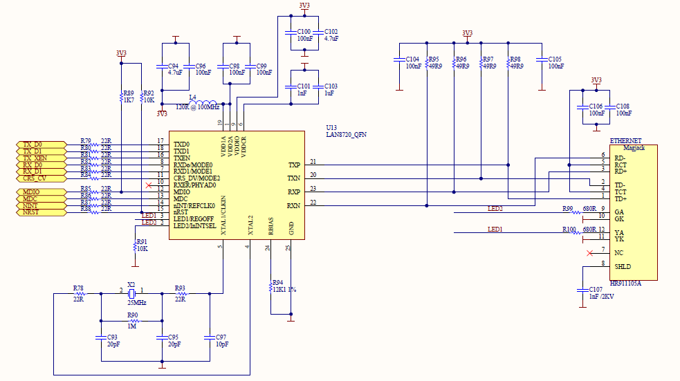

PIN10 PHYAD0 is unconnected and has internal PULLDOWN, so I think your PHYADD is 0.2016-06-08 1:24 PM
Hello Thomas,
thanks for the feedback. I changed the value, but still i doesn't work ...any other tips?2016-06-08 6:20 PM
Hi , I had the same problem , I just solved it
I have the same hardware with LAN8720 phy IC and it didn't work with HAL , it was working good with STL. However I disabled the autonegotiation and now the problem is solved instead of//heth.Init.AutoNegotiation = ETH_AUTONEGOTIATION_ENABLE;
I added those three lines in the low_level_init()
heth.Init.AutoNegotiation = ETH_AUTONEGOTIATION_DISABLE;
heth.Init.Speed = ETH_SPEED_100M;
heth.Init.DuplexMode = ETH_MODE_FULLDUPLEX;
also added those lines at the end of the HAL_ETH_MspInit() as you did.
GPIO_InitStruct.Pin = GPIO_PIN_2;
GPIO_InitStruct.Speed = GPIO_SPEED_FREQ_HIGH;
HAL_GPIO_Init(GPIOE, &GPIO_InitStruct);
HAL_GPIO_WritePin(GPIOE, GPIO_PIN_2,GPIO_PIN_RESET);
HAL_Delay(10);
HAL_GPIO_WritePin(GPIOE, GPIO_PIN_2,GPIO_PIN_SET);
HAL_Delay(10);
and now the problem is solved , it seems that HAL doesn't support the autonegitiation for the LAN8720 , and the negotiation code is wrote for the ''DP83848'' which probably the PHY IC on the new nucleo boards, as I noticed that it read and write wrong values from wrong registers , I don't really know , also I debugged the STL code I found that after negotiation it continue to the default values (full duplex , 100M)not that values from the LAN8720, So I did the same and the problem is solved.
I really hope any expert tell us what's the real problem , is the HAL_eth is wrote only for DP83848 or we have wrong configurations ?!! taking in consideration that I took the configurations from STM32cubeMX configuration tool , but it doesn't solve the problem , it only solved when I disabled the autonegotiation.
Note : gw_addr is the address of the gateway in your network , because I read part of your code and it have the ip_addr the same as gw_addr.
