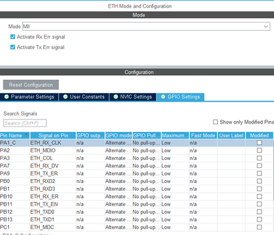

2023-12-05 10:26 PM
Here are my solutions form my project (STM32H725IGKx with STM32CubeMX (6.10.0)).
Problem was that I had HAL_ETH_ERROR_TIMEOUT. So the SWR bit (ETH_DMAMR_SWR) was not set to 0:

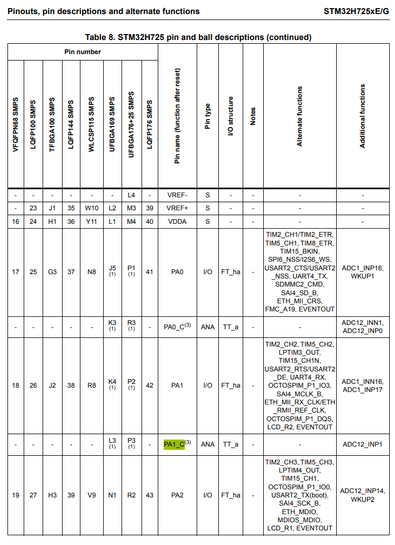

SYSCFG->PMCR &= ~SYSCFG_PMCR_PA1SO_Msk;
/* USER CODE END MACADDRESS */
if (HAL_ETH_Init(&heth) != HAL_OK)
Error_Handler();
I didn’t found a possibility to change it in the STM32CubeMX (6.10.0)
