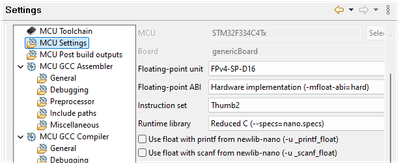

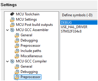

Let's do a quick experiment.
Run CubeMX v. 6.11.1. Created a new project for the 1st STM32F334 listed in the MCU selector. It was STM32F334C4T6. Did not configure anything, just set the project type as STM32CubeIDE and generated code.
Guess what, the CMSIS device definition file stm32h334x8.h does contain
#define __FPU_PRESENT 1U
Can you try this for your specific STM32F3?
