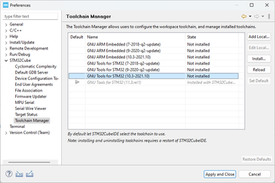

Can also just install the previous toolchain easily enough...
2023-08-16 3:21 PM
Installing GNU Tools for STM32 version 10.3 worked perfectly for me. Printf stopped calling the error handler. Thanks!
